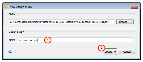

On the New Design Study dialog, click Browse.
On the File manager dialog, navigate to Users\Public\Public Documents\Autodesk\CFD 2021\Tutorials\<file type>\receiver.
Notes:
Click Open.
Step 3: Create the Design Study
  1. Enter a Name for the new design study. This can be anything you want.
  2. Make sure that Create is the active option on the button, and click Create.
new design study
Autodesk® CFD starts, and creates the Design Study for the tutorial.
