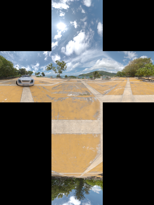

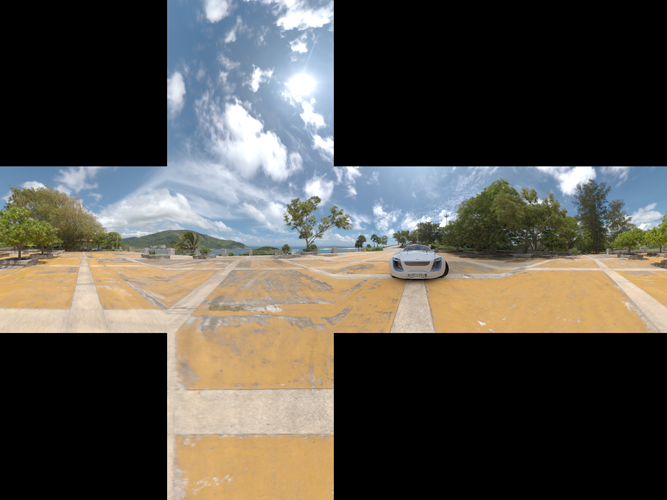

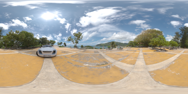

Set the type of cube image rendering:
Separate Images (six planar images)
Vertical Cross
Horizontal Cross
Spherical Map
