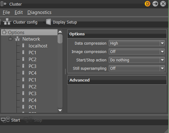

Head and rendering nodes are connected through a network. The configuration is presented as a tree view with the global options, network options, and options for each rendering node.
Choose Rendering > Cluster to open the Cluster module.
In the left panel, select Options and choose Edit > Add network.
Do any of the following:
To add rendering nodes individually, choose Edit > Add compute node and provide the Name under Compute node in the right panel.
To add many nodes at once, choose Edit > Cluster config to open the Cluster config dialog box.
In the Configuration text box, add the configuration. A wide range of formats is recognized, including the connection string from the Cluster module in previous VRED releases.

Set cluster, network, and render node options in the right panel of the dialog.
To display cluster options, select Options in the left panel.
To display network options, select the Network node in the left panel.
To display render node options, select the node in the left panel.
