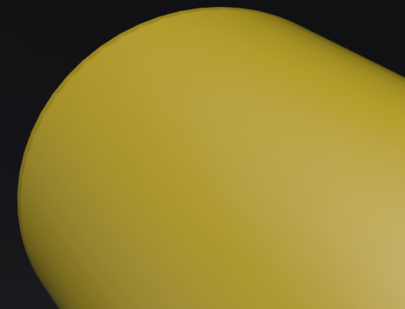

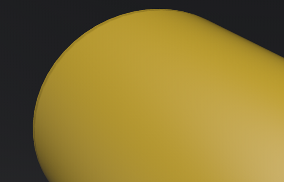

Have you wanted an effect that simulates a smooth edge between adjoining faces? Set the Rounded Edges parameters to do just that. Use them when presenting a prototype model. By setting these, you can convey the look and feel of a properly modeled object, without the extra upfront effort. If the design is approved, then the additional modeling effort can begin.
Not using Rounded Edges
Using Rounded Edges
