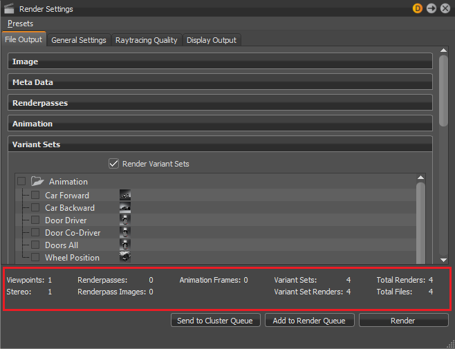

Find the render summary above the Send to Cluster Queue, Add to Render Queue, and Render buttons.

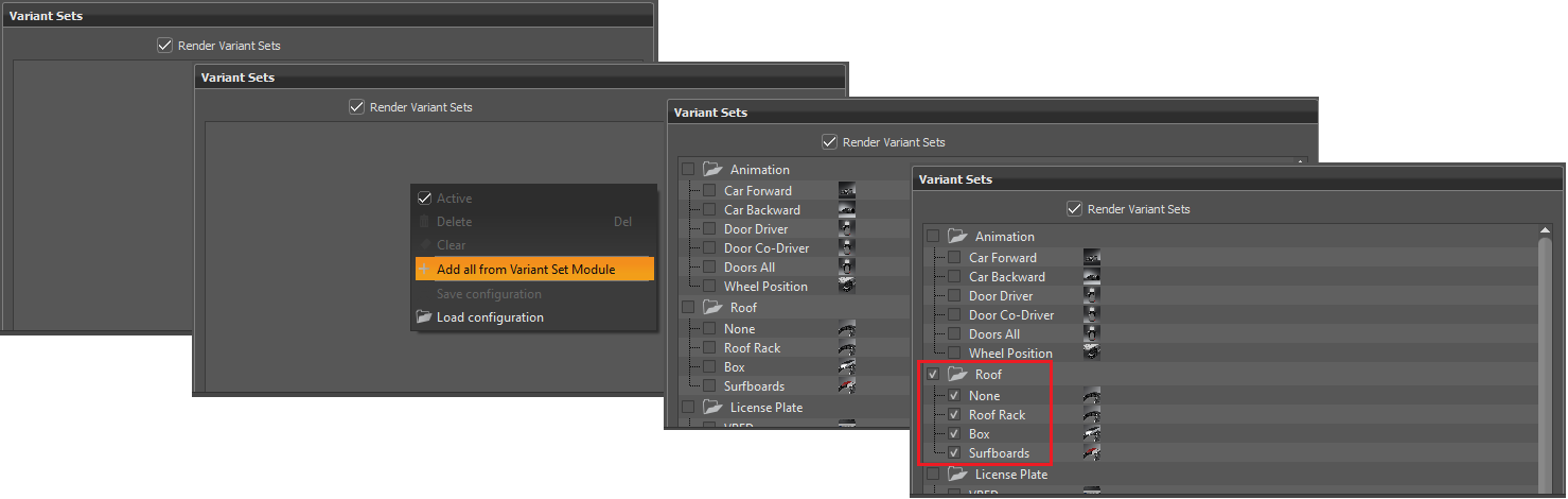

Use the Variant Sets section to easily render multiple versions of a model in VRED. Render a red car in a garage, yellow car in a garage, and red car in park, in one render job. Material and environment variant sets can be set by checking what's wanted and unchecking what's not.

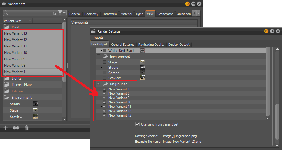

If you reorder groups by click-dragging, this changes the render and naming order of your files. Reordering is not permitted on a per variant set basis, only with groups.
When ungrouped variant sets are dragged from the Variant Sets module to the Variant Sets section of Render Settings, they will be grouped under the same parent node, named ungrouped. This treats all ungrouped nodes as if they belong to one group to simplify deleting, dragging and dropping, and selecting/deselecting.

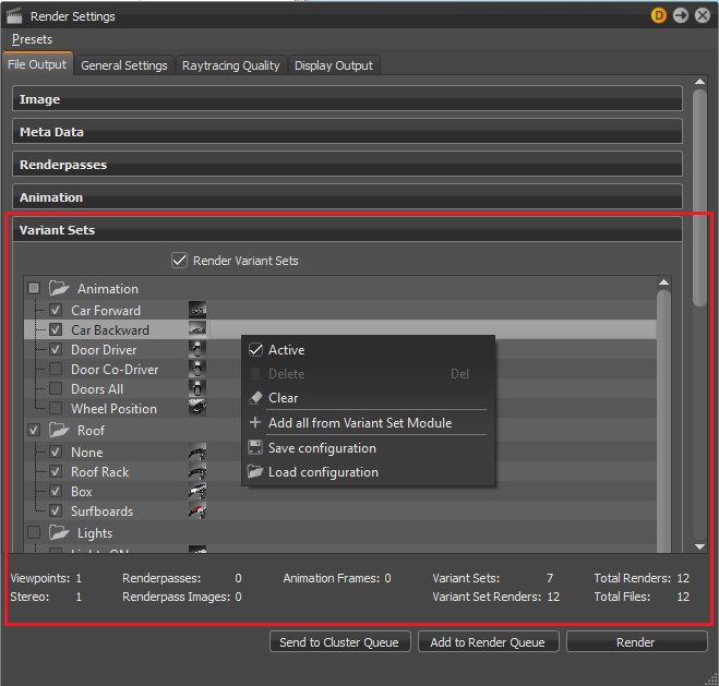

Enables variant sets to be added to the render job. Right-click to access a context menu with the following options:
Active - Adds checks to all selected variant sets (materials, geometry, and environments) in the Variant Sets section and adds their information to the Render Summary at the bottom of the module.
Delete - Deletes entire folders of variant sets from the Variant Sets section.
Clear - Clears all variant sets from the Variant Sets section and removes all information from the Render Summary below. To add them back, use Add all from Variant Set Module.
Add all from Variant Set Module - Adds all variant sets in the current scene to the Variant Sets section. Check a variant set to render it. To select everything in a folder, check the folder. To deselect everything in a folder, uncheck the folder.
Save configuration - Saves the configurations as an XML file. This is useful to keep along side your VPB files to get the same rendering results another time.
Load configuration - Reloads the XML configuration file for design reviews, so you have the same results as before.

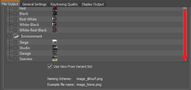

At the bottom of this section, the naming scheme and an example file name are displayed. The naming of the rendered files uses a combination of the variant set names to form the final file name. A unique indentifier can be added to the beginning, but only at the time when selecting the render job save location.

The Render Summary is above the Send to Cluster Queue, Add to Render Queue, and Render buttons. Get more contextual information about the render and how long it could take. Get the total number of images and renders.
The same information is also available in the Render Queue, just in a different format.
Click one of the following button, which appear at the bottom of the module, to start image calculations.
Renders to the Cluster Queue; however, you must be logged into the Cluster Manager before sending anything to the Cluster Queue. See To Manage Cluster Rendering.
Creates a job from the current camera view and adopts last settings from the render module, after submitting the Render Queue Window opens. Image names cannot be changed, since there are multiple jobs being rendered. A notification appears if rendered images are going to be overwritten.
Creates the image or movie with current settings. An image's name can be changed during this process.
