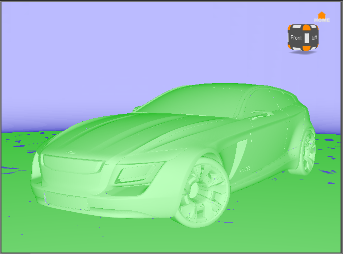

Face and vertex normals can point toward or away from the camera. They might both point the same way ("consistent") or opposite ways ("inconsistent"). Use Vertex/Face Normal Rendering mode to identify the orientations that exist in your scene.
Orientations are identified by color:

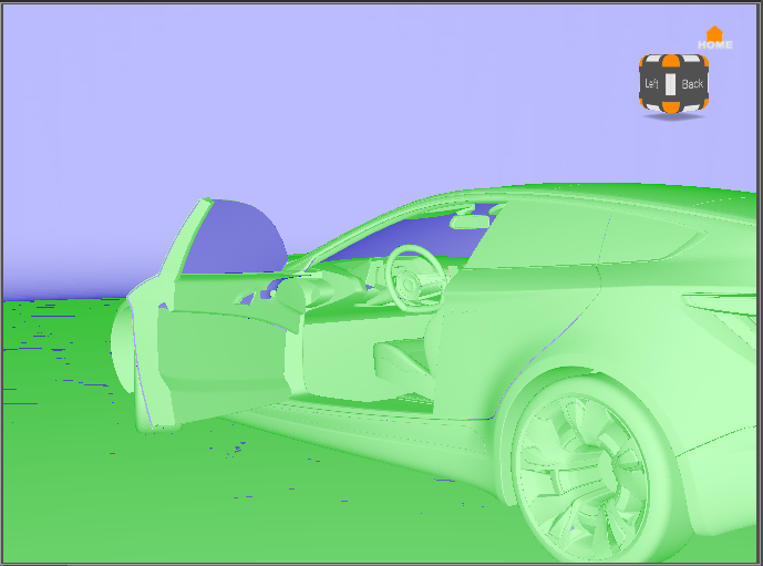

Green - Face and vertex normals are consistent and point toward the camera.
Blue - Face and vertex normals are consistent and point away from the camera.

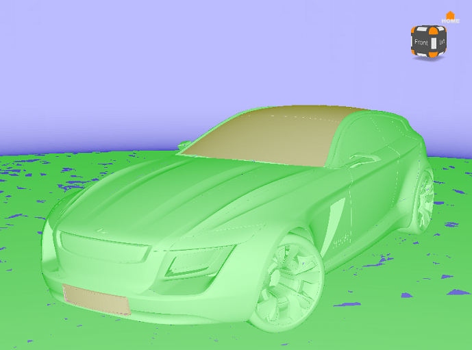

Gold - Face and vertex normals are inconsistent. The face normals point away from the camera, while the vertex normals point toward the camera.

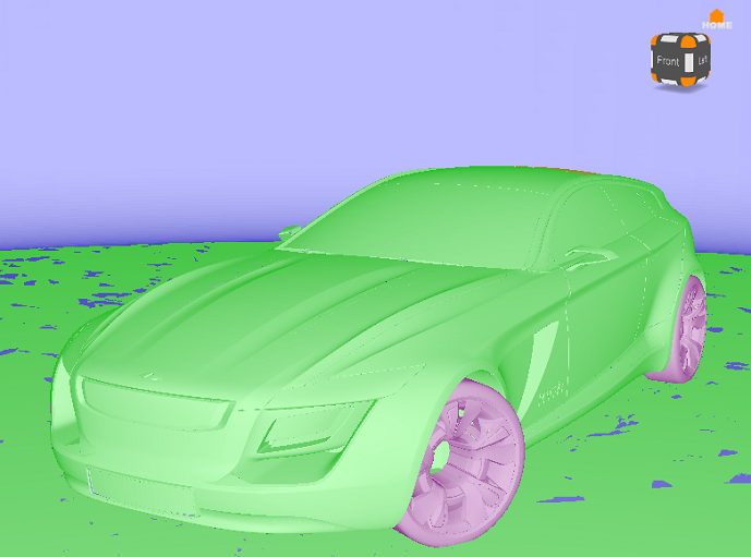

Magenta - Face and vertex normals are inconsistent. The face normals point toward the camera, while the vertex normals point away from the camera.
