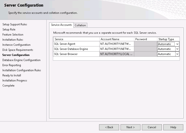

  8. In the Server Configuration window, select the Service Accounts tab.
    • Specify the NT AUTHORITY\NETWORK SERVICE account for the SQL Server Database Engine. The local system account is also acceptable to use. If you plan to perform backups and restores to remote locations, specify a Domain User account. Set the Startup Type to Automatic.
  9. Click Next.

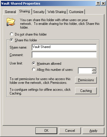

  1. Choose a network location and create a folder.
  2. Right-click the new folder and then select Sharing and Security.
  3. In the Properties dialog box, click Share this folder.
  4. Enter a name for the shared folder.
  5. In the Comment field, enter Shared network folder for Autodesk Vault.
  6. Click Permissions.
  7. In the Permissions dialog box, click Add. Add the user account under which ADMS is running. By default, this account is a local administrator account on the ADMS server called Autodesk Vault.
  8. Add the Windows account under which the SQL Server service is running. The default is Network Service.
  9. Give both accounts Full Control.
  10. In the Permissions dialog box, click OK.
  11. In the Properties dialog box, click OK.
