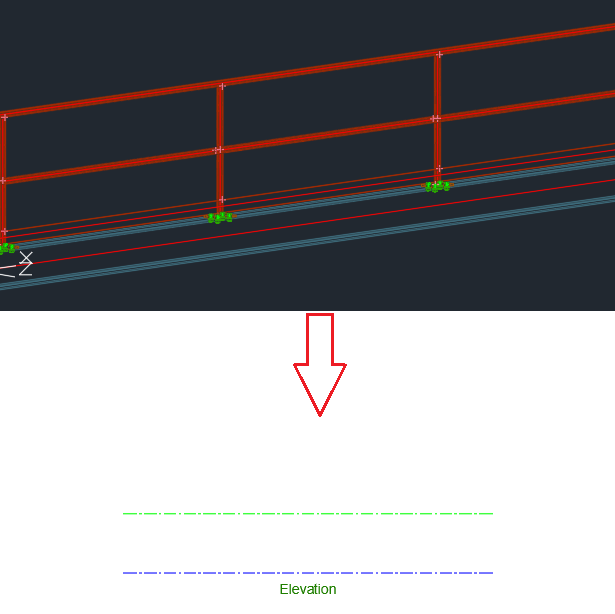

The example is based on the following requirement: Objects that have a different role in the model should be printed with a different line-type, and also have a different labeling strategy.
Using this workflow it is possible to plot two beams detailed as visible, but with different structural roles and with two different line types. This configuration does not apply to the DWG file (where the difference is only the used color). The configuration applies when sending to any type of plotting (PDF, paper), the CTB file will control the line type.
Sample model and drawing style: an elevation view on a support beam and a railing.

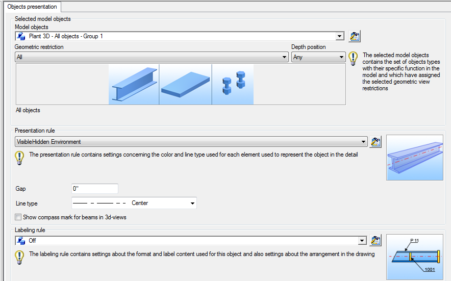

(New) button from the Object presentation tab.
(Add a new object presentation) button in the Object presentation tab. The two new rules will be added to the end of the list and they will be a duplicate of the first rule - will be changed as part of this configuration.

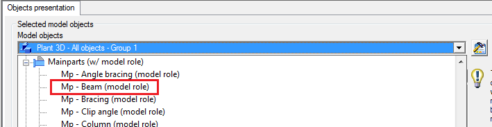

Model object: This option will control what object from your model will be detailed by this specific line. Part of this configuration is to match specific model roles - those model objects need to be selected to match the object type (beam, plate, etc) and the model role. Search through the list and select the required model role. The out-of-the-box Advance Steel provides a wide series of pre-configured model objects. The model object for beams with the Beam model role exists and it is named Mp - Beam (model role).
(Set) button next to the Model object category to access the configuration page.
(New) button.

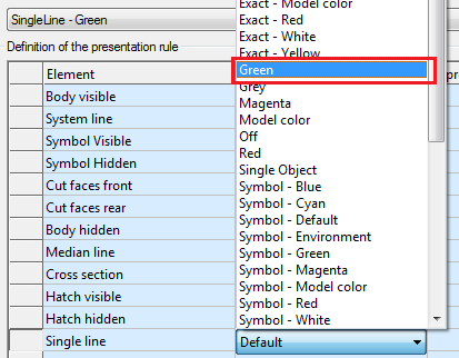

In order to control the color of the two rules, you need two new object presentation rules, based on the SingleLIne rule - but using different colors.
(Set) button for the Presentation rule category to open the Presentation configuration panel. The default SingleLine presentation, found in the out-of-the-box installation, is configured with the Single line element set on the default color - which means Advance Steel will use the color set in the Management Tools defaults for Single Line objects.

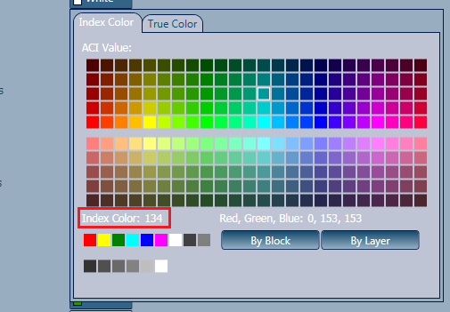

Add more color values to the object presentation configuration table
You can add more color values to the object presentation rule configuration, by editing a database as follows:
