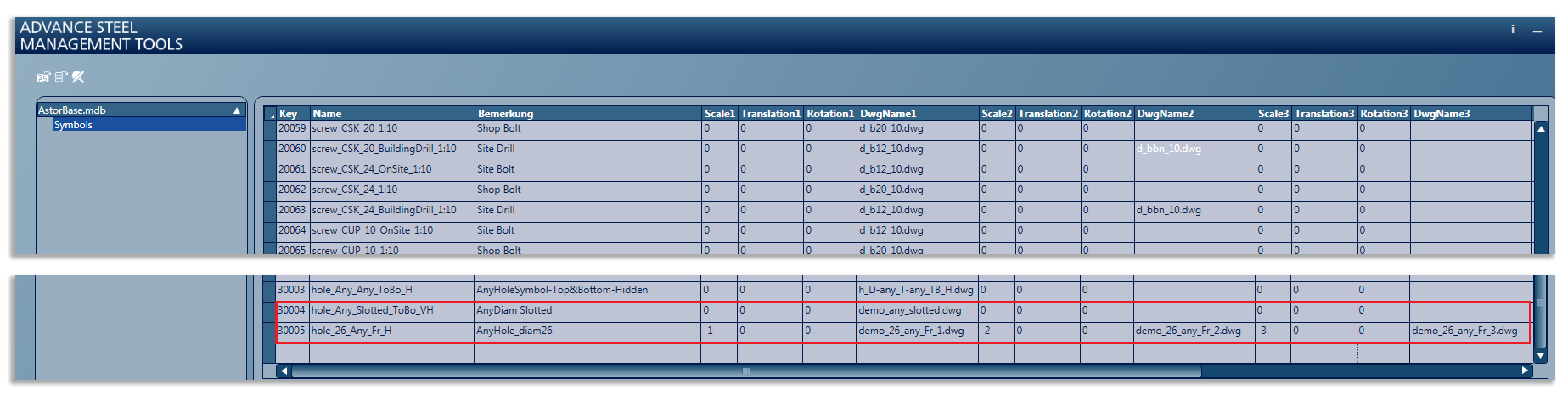

In order to start configuring a hole symbol, you need to access the AstorBase database
Symbols table. To do this:

Examples:
hole_Any_Slotted_ToBo_VH - all diameters for slotted holes, with a top / bottom view direction and a VisibleHidden visibility status.
hole_26_Any_Fr_H - any type of hole with the diameter equal to 26, viewed from the front and with a Hidden visibility status.

This is how the two example hole symbol configuration lines appear in the Symbols table:
