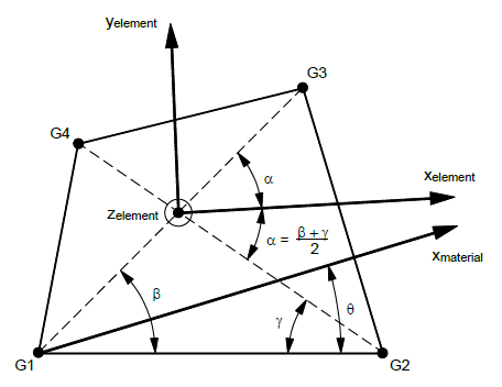

  2. Grid points G1 through G4 must be ordered consecutively around the perimeter of the element.
  3. All the interior angles must be less than 180 degrees.

Figure 1: MCID coordinate system definition
Figure 2: CQUADR element geometry and coordinate system

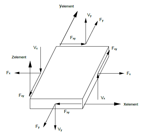

Figure 3a: Forces in CQUADR elements

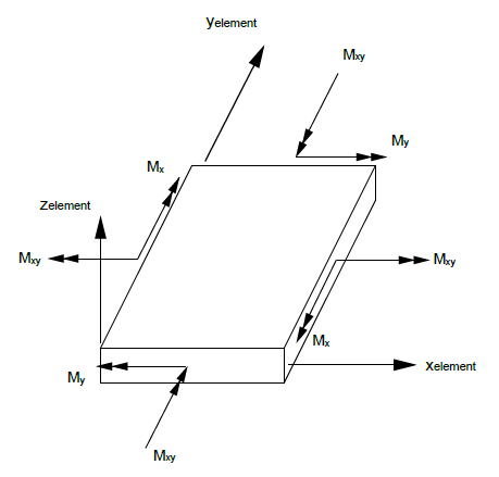

Figure 3b: Moments in CQUADR elements

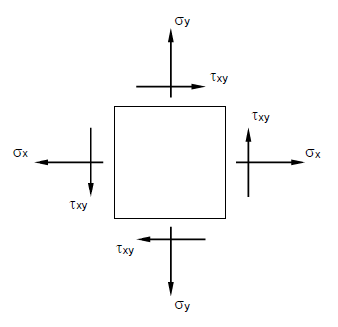

Figure 4: Stresses in CQUADR elements
