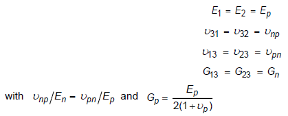

  4. It may be difficult to find all nine orthotropic constants. In some practical problems, the material properties may be reduced to normal anisotropy in which the material is isotropic in a plane (that is, plane 1-2) and has different properties in the direction normal to this plane. In the plane of isotropy, the properties are reduced as follows:
    There are five independent material constants for normal anisotropy (that is, Ep, En, p, np, and Gn). In case the material has a planar anisotropy, in which the material is orthotropic only in a plane, the elastic constants are reduced to seven(E1, E2, E3, 12, G12, G23, and G31).
