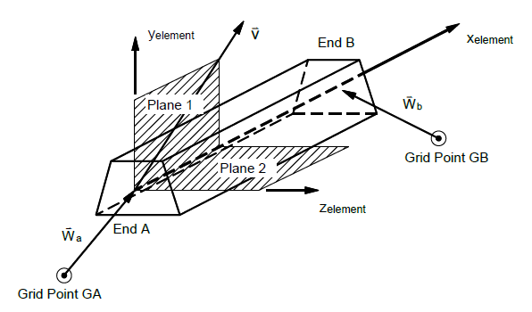

| X1, X2, X3 | Components of vector
, from GA, in the displacement coordinate system at GA (see Figure 1).

| G0 | Grid point identification number to optionally supply X1, X2, and X3. Direction of orientation vector is GA to G0. | Integer or blank |

Figure 1: CBAR element geometry

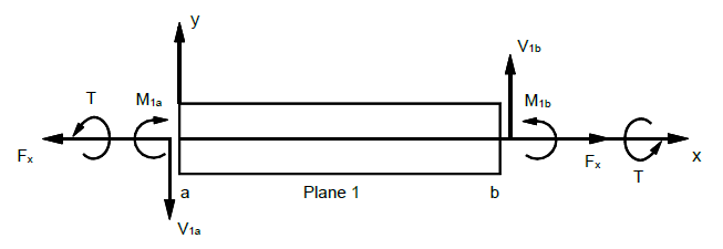

Figure 2: CBAR element internal forces and moments (x-y plane)

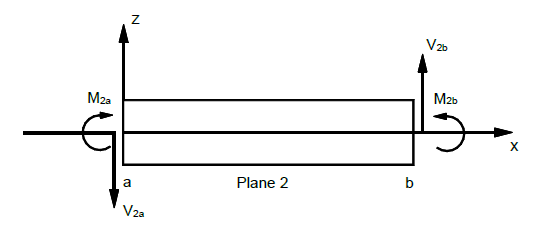

Figure 3: CBAR element internal forces and moments (x-z plane)
