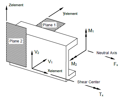

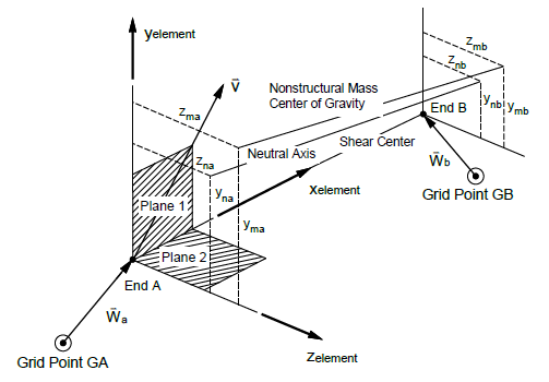

  2. The following figure defines beam element geometry:
    Figure 1: CBEAM element geometry system
    Figure 2: CBEAM internal element forces and moments
