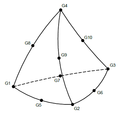

The CTETRA entry defines the connections of a four-sided solid element with four grid points.
Format

Figure 1: CTETRA element connection
Remarks
  1. Element identification numbers must be unique with respect to all other element identification numbers.
  2. The topology of the diagram must be preserved: for example, G1, G2, G3 define a circular face.
  3. Components of stress are output in the global coordinate system, unless a material coordinate system is defined on the PSOLID option.
  4. Figure 1 shows the numbering for both a four-node and a ten-node tetrahedral element. Autodesk Explicit supports only a four-node tetrahedral element.
