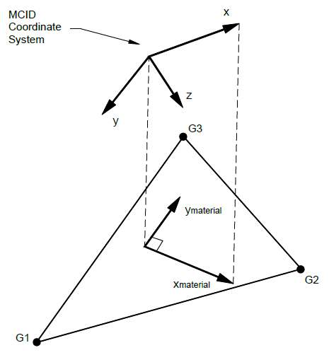

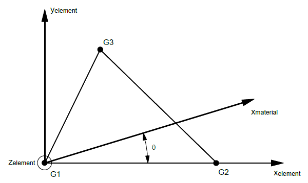

THETA Material property orientation angle in degrees. Real See Remark 4
MCID Material coordinate system identification number. Integer ≥ 0 See Remark 4

Figure 1: MCID coordinate system definition
Figure 2: CTRIAR element geometry and coordinate system
