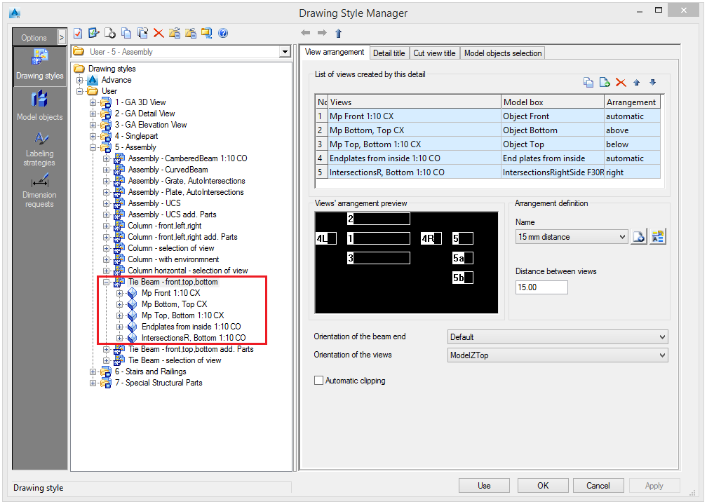

A drawing style is composed of one or several views. A view has properties, objects, dimensions and labels. The drawing style also has properties accessible on the properties panel.
The drawing style has properties accessible on the properties panel using three tabs:
Views arrangement - Select views, their orientation, their arrangement, and the distances between them.
Detail title - Define the title content, using the label designer, and its position.
Model object selection - Define the objects that will be detailed by the selected style. For example, the drawing style can use Single Parts, Main Parts or All objects (overviews).
