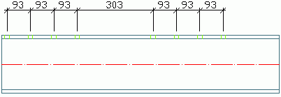

Optionally, dimensions for bolt and hole groups on secondary parts can be grouped. This option creates a dimension line for each group and dimensions the objects in the group.
The drawing style can be configured to automatically get the desired result.
Option | Result |

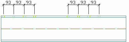

This option prevents a dimension from combining with others. This increases the drawing quality when two similar dimensions must remain separate even if they have dimension points from the same line, or show the same values.
Option | Result |
