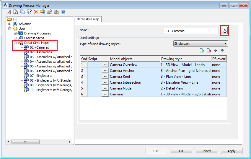

- Drawing styles - Detail style map: This is the main configuration of a process that assigns a drawing style to each detailed object. To access the Detail style map configuration,
(Properties) button.
Create a new style map to start configuring it:
The detail style map is a simple tool that creates a rule connection between the model object and the drawing style you want to use to detail that specific model object. In the camera process case, this rule is created between model objects that represent the different camera types in the model, and drawing styles specifically configured to create dedicated drawing for each case. For example, in the following image, the Camera Anchor type is assigned to an anchor plan drawing style, while the Camera Roof type is assigned to a plan view drawing style. Using this configuration the process can become a good all-around detailing tool that will create details for the entire model, with only one click.
