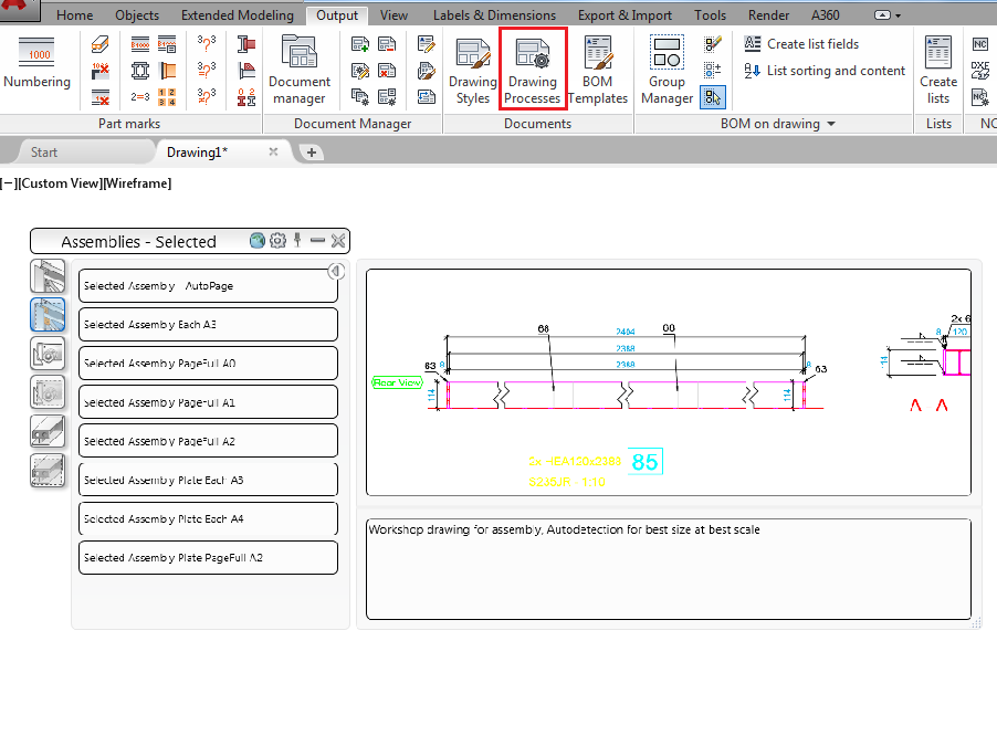

You can access the drawing processes from the Drawing Process Manager, the Drawing Processes Palette or manually using commands.
You can access the default processes from the Output tab Document Manager panel, click
(Drawing process manager).
Alternatively, you can access the drawing processes using the Drawing Processes Palette, in the Output tab Documents panel:

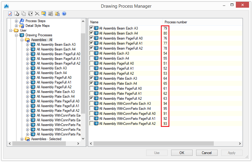

You can also call processes manually, using the _AstM4CommDetailingProc User command and the process number. The process number column displays the number associated to each process.
Example:
_AstM4CommDetailingProc User 52 calls the All Assembly PageFull A1 drawing process.
