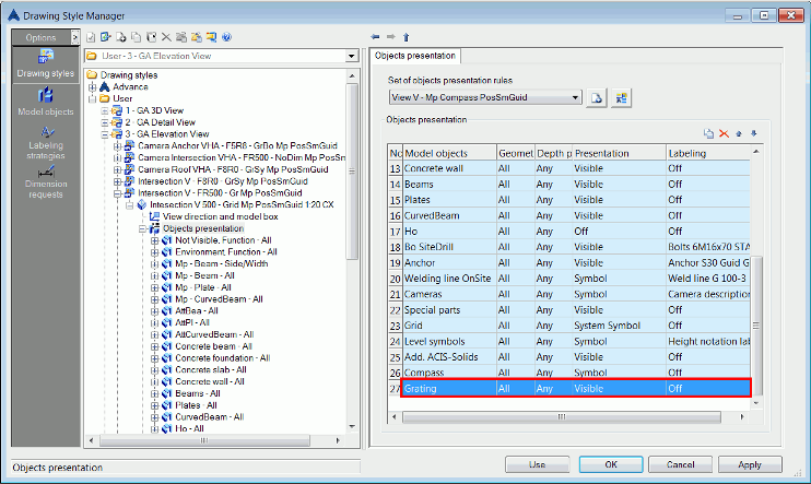

To detail a grating in the overview drawings, it needs to be added to the drawing style.
- Open the Drawing Style Manager: Output
Document Manager
(Drawing Style Manager).
- Select a drawing style in which you want to add the grating representation, for example, Intersection V - FR500 - Gr Mp PosSmGuid. Then, go to the Object presentation.
- Add a new object presentation:
- Configure the new presentation with:
- Model object: Grating
- Geometrical restrictions: All
- Depth position: Any
- Presentation: Visible (to represent only the grating contour) or Visible HatchVisible (to represent the hatch as well).
- Labeling: Off, or any other label if the grating mark needs to be displayed.
- Click Apply to save the drawing style.
