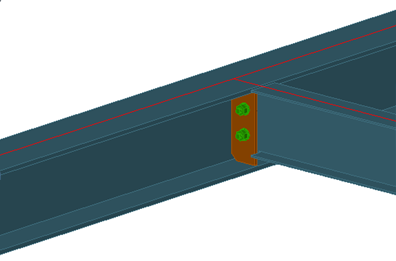

Example: Create a Shear Plate Connection
In this example, you will create a shear plate connection between the support beams and the floor beams.
On the ribbon, click
(Connection Vault).
Home
Extended Modeling
(Connection Vault)
Extended Modeling
Joints
(Connection Vault)
From the Platform Beams category, select
Select the support beam and right-click.
Select one of the floor beams and right-click to create the connection.
The plate is created and the Shear Plate properties dialog appears. Modify the plate properties to suit specific requirements.
