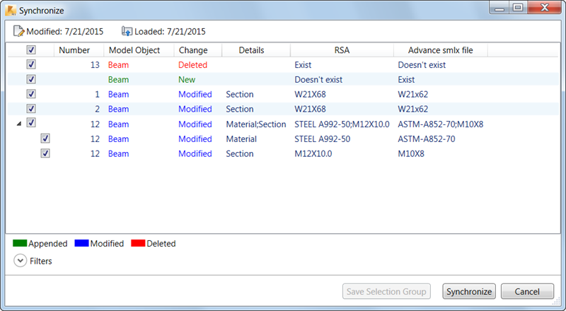

In the Synchronization dialog, the main modification tick box is selected by default. You can deselect it and then select individual modifications to apply.
Modified objects display in blue. Information about the scope of modification displays in the Details column. If you select a modification line in the dialog, the corresponding modified element is highlighted in the drawing area.
If an object modification includes more changes than one, click
at tick box in the modification line to expand the list of changes to the object. Each change has a tick box and can be accepted individually.

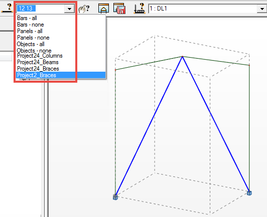

Click Save Selection Group to save modified objects that you selected as a group in Robot. After you synchronize modifications in your model, you can use this group to track modifications to objects in the group.
To select a single modification line, click the line. To multi select lines, click individual lines while holding the Ctrl key down.
After you select modification lines, the Save Selection Group button becomes active.
The selection group is saved. After you synchronize modifications in your model, you can select this group on the Selection toolbar. All objects in the group are highlighted in the drawing area then.

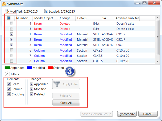

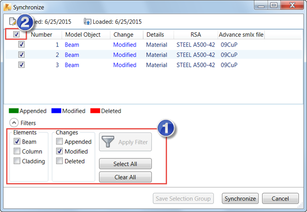

The main tick box work with applied filters. If objects are selected using the filters and a main tick box is activated, only those lines will have the individual tick box selected. It is illustrated in the following images.
Only the lines with modified beams have the individual tick boxes selected.
