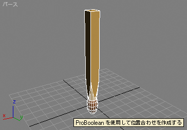

例 1
    --Creating a match using two consecutive boolean operations between
    --a box, a cone and a sphere:
    theBox = box height:100 width:10 length:10--create a box
    theCone = cone radius1:4 radius2:15 height:110--create a cone
    theSphere = sphere radius:6--create a sphere
    xf = xform()--create an XForm modifier
    addModifier theSphere xf--add the XForm to the sphere
    xf.gizmo.scale = [1,1,2]--scale the sphere along Z
    --create an intersection of the box as operand A and the cone as operand B:
    ProBoolean.createBooleanObject theBox theCone 1 0 0
    --assign materials to the box and to the sphere:
    theBox.material = standard diffuse:(color 255 200 100)
    theSphere.material = standard diffuse:brown
    ProBoolean.SetBoolOp theBox 0--set the boolean operation to union
    ProBoolean.setOperandB theBox theSphere 0 0--add the sphere asnewoperand B

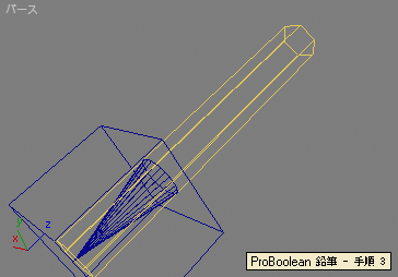

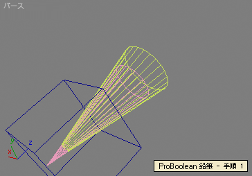

例 2
    --Creating a Pencil using multiple boolean subtractions
    --of a box, two cones and a cylinder:
    --Step 1: create a box and two cones, assign materials:
    theBox = box height:50 width:50 length:50 pos:[0,0,-2]
    theCone1 = cone radius1:3 radius2:20 height:80 heightsegs:1 pos:[0,0,15]
    theCone2 = cone radius1:0 radius2:15 height:80 heightsegs:1
    theCone1.material = standard diffuse:(color 255 220 200)
    theCone2.material = standard diffuse:black

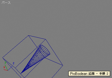

    --Step 2: Subtract both cones from the box
    ProBoolean.createBooleanObjects theBox #(theCone2,theCone1) 2 0 0

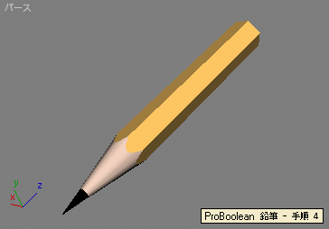

    --Step 3: Create a 6-sided cylinder and assign a material
    theCyl = cylinder radius:10 sides:6 height:150 smooth:false pos:[0,0,1]
    theCyl.material = standard diffuse:(color 255 200 100)
    --Step 4: "sharpen" the cylinder using the box with the conical hole
    ProBoolean.createBooleanObject theCyl theBox 2 0 0
