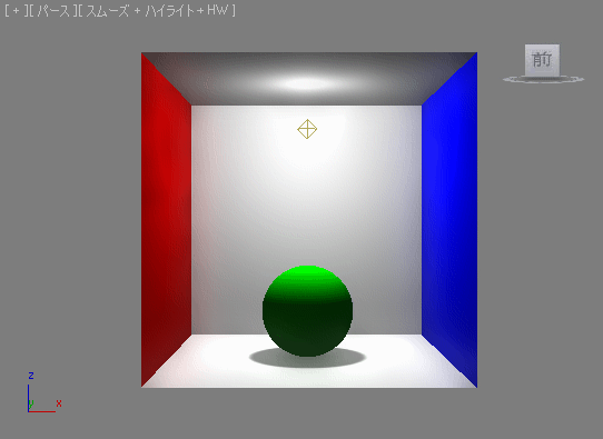

コーネル ボックスの例:
    resetMaxFile #noPrompt
    viewport.setTM (matrix3 [1,0,0] [0,0,-1] [0,1,0] [6,-150,-800])
    bx = box width:300 height:300 length:300 backfacecull:true
    addModifier bx (normalModifier flip:true)
    mtl = multiMaterial numsubs:6
    mtlred = standard diffusecolor:red
    mtlblue = standard diffusecolor:blue
    mtlwht = standard diffusecolor:white
    mtl.materialList = #(mtlwht,mtlwht,mtlred,mtlblue,mtlwht,mtlwht)
    bx.material = mtl
    om = omniLight pos:[0,0,250] rgb:white shadowMultiplier:0.5
    om.baseobject.castshadows = true
    sph = sphere radius:50 pos:[0,0,50] segs:32
    sph.material = standard diffusecolor:green selfillumamount:15.0
    vss = maxops.getViewportShadingSettings()
    vss.ActivateViewportShading = true
    vss.ShadowsActive = true
    vss.IndirectLightingRadius = 200
    vss.IndirectLightingQuality = #medium
    vss.IndirectLightingMode = #ILAOComposite
結果:

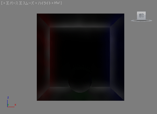

    vss.IndirectLightingMode = #ILOnly
結果(間接光のみ)

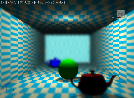

DOF ボックスの例:
    bx = box width:500 height:300 length:2000 backfacecull:true
    mp1 = checker color1:[0,200,255] color2:[255,255,200]
    mp1.coords.U_Tiling = 10
    mp1.coords.V_Tiling = 10
    bx.material = standard diffusecolor:white diffusemap:mp1
    showTextureMap bx.material mp1 true
    tp1 = teapot radius:50 pos:[80,-250,0]
    tp1.material = standard diffusecolor:red
    tp2 = teapot radius:50 pos:[-100,500,0]
    tp2.material = standard diffusecolor:blue
    vss.ShadowMode = #Soft
    vss.AmbientOcclusionMode = #AOComposite
    vss.DepthOfFieldActive = true
    vss.DepthOfFieldNearPlane = 300
    vss.DepthOfFieldFarPlane = 1500
    vss.DepthOfFieldFocusPlane = 800
結果:
