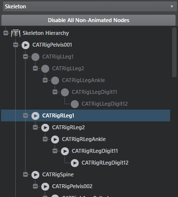

Enable or disable animation per node
Choose Skeleton in the drop-down list to set which of your skeleton's nodes should be animatable and which should not.
When you disable a node, it will never play any animation contained for it in any animation clip that you play on that skeleton. It will freeze in local space. Disabling nodes that you don't need to animate can be useful in order to optimize the memory and performance of the animation system.

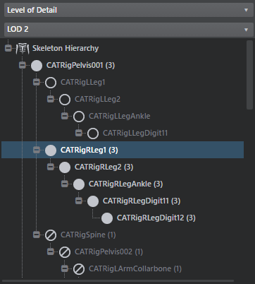

Assign nodes to different levels of detail
Choose Level of Detail in the drop-down list to set which of your skeleton's nodes should be animatable at each different level of detail.
Levels of detail can help you increase the performance of the animation system by disabling animation for pre-defined sets of nodes in the skeleton at different times or in response to different runtime circumstances.
Each level of detail enables animation for a sub-set of nodes in the skeleton. When you activate that level of detail for a unit's skeleton in the engine at runtime, that set of nodes is enabled in addition to all nodes that are enabled at less detailed levels.
See the details on the Animation optimization page for more.

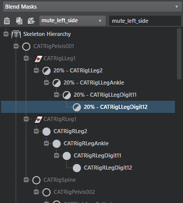

Manage blend masks
Choose Blend masks in the drop-down list to set up your skeleton's blend masks, which control the blending between different animation layers that are playing at the same time on a skeleton.
Each blend mask stores a weight value for each node in the skeleton. You can assign one of these blend masks to each animation state in the animation controller that controls this skeleton. When you have two or more animation layers that need to play different states on the same skeleton at the same time, the blend mask that is assigned to each state controls how strongly that state is weighted when coming up with the final result for the skeleton in each frame:
Use the control strip at the top of the panel to manage the blend masks that are available for this skeleton, and to select a blend mask whose weights you want to edit:

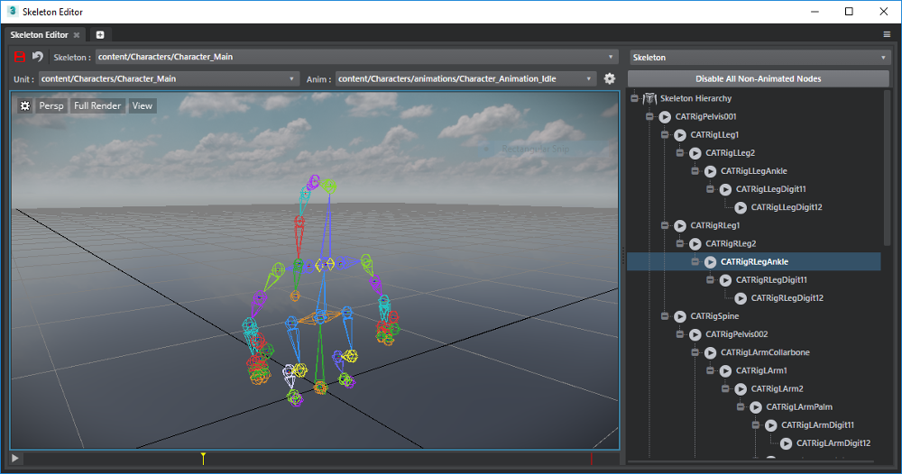

Change the preview
The viewport of the Skeleton Editor panel shows a preview of the changes you make to your skeleton's animation settings. You can use the preview controls to change what you see in the viewport:
None of these settings affect the skeleton resource itself. They only change the preview that you see in the viewport.
