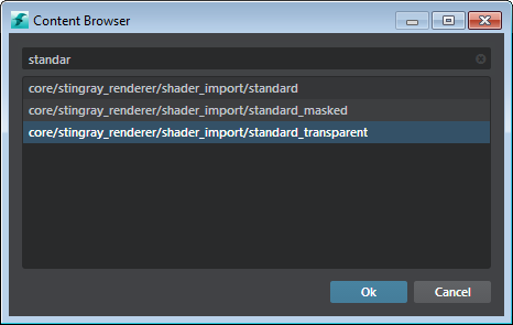

Change the parent material
Parent Material is the first property listed for every material in the Property Editor.
The parent material determines the properties that are available for all instances of a material in the Property Editor, so changing the parent material can change the rest of the properties you see.
For example, to change a material that uses the "standard" material as its parent to instead use the "standard transparent" material:
  1. In the Property Editor, click the Select resource icon next to Parent Material.
    The Content Browser displays, which lists all possible materials in your project, including all child materials.
  2. In the Content Browser, start typing in the Search field to narrow the listings, and select the new parent material.
