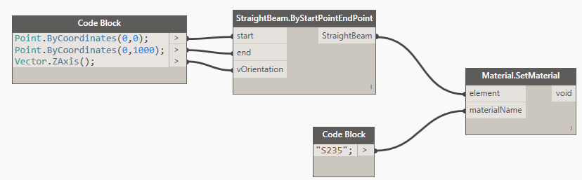

To assign materials to elements in Dynamo:
In the tree menu on the left, expand the AdvanceSteel tab
Tag
Material and select SetMaterial. The Material.SetMaterial node appears in the workspace.
In order to set the material, you need to have two inputs as in the image below:

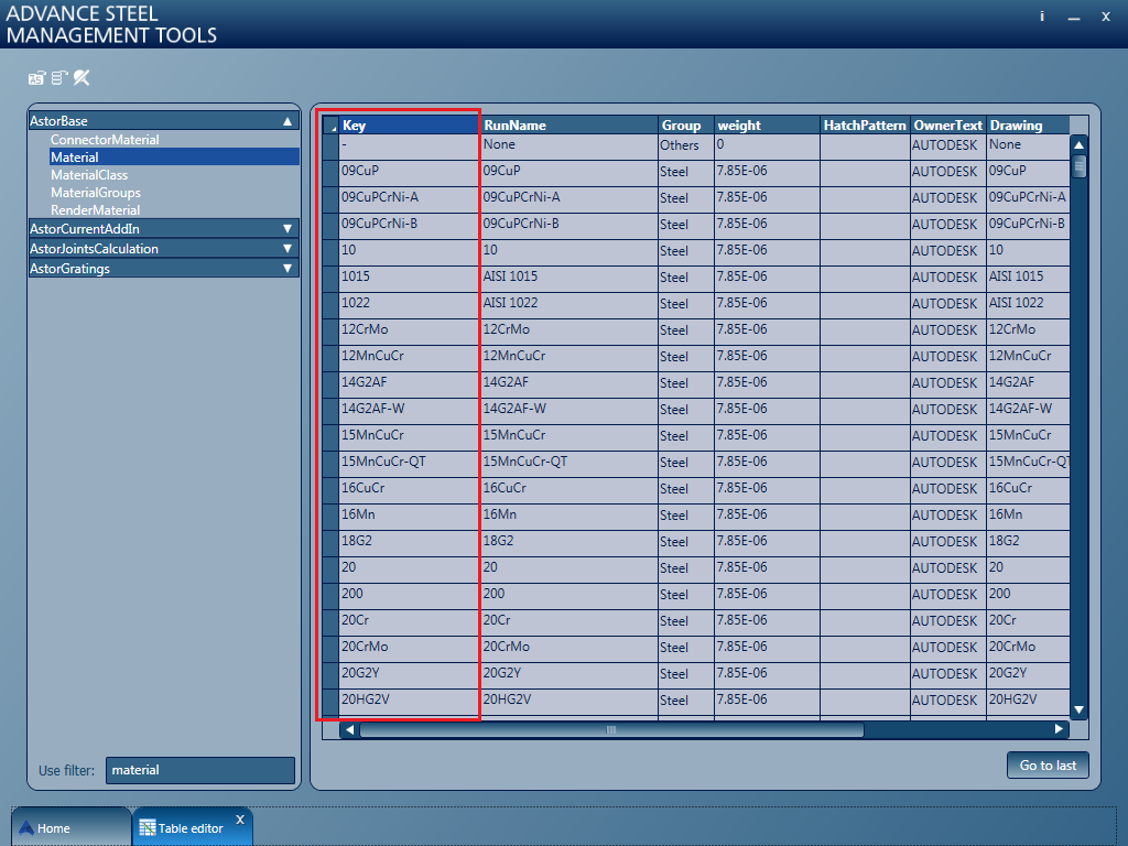

(Management Tools) in the Advance Steel Home tab
Settings panel. In the Management Tools application, access the Table Editor, click the button in the top right corner (Open ODBC) to load the Advance Steel databases and use the filter in the bottom right to search for "material". Access the Material table under AstorBase to see the material keys:
