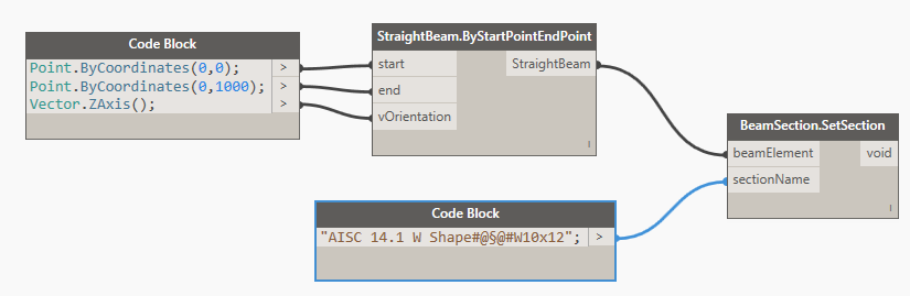

Learn how to assign a section to Advance Steel elements using the Dynamo extension.
To assign a beam section in Dynamo:
In the tree menu on the left, expand the AdvanceSteel tab
Tag
BeamSection and select SetSection. The BeamSection.SetSection node appears in the workspace. This node works for both beams and plates.
In order to set the section, you need to have two inputs as in the image below:
