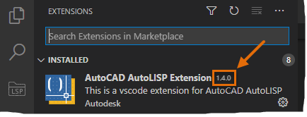

How you configure the AutoLISP Extension for debug depends on which version you are using. The following steps explain how to identify which version of the extension you are using:
- In Visual Studio Code, click File menu > Preferences > Extensions.
- In the Extensions view, clear any text from the Search box.
- Under the INSTALLED section, locate AutoCAD AutoLISP Extension in the list.
The version number of the extension will be next to its name.

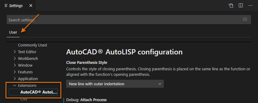

- In Visual Studio Code, click File menu > Preferences > Settings.
- On the User tab, expand Extensions and click AutoCAD AutoLISP Configuration.

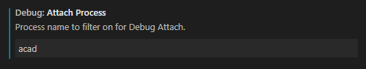

- In the Debug: Attach Process text box, enter one of the following values in bold:
- (Windows)
acad
- (Mac OS)
AutoCAD
Note: The process name is case sensitive, so acad or AutoCAD isn’t the same as ACAD or autocad.

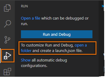

Note: A folder must be opened before debug configurations can be added, and debug configurations should not be added to a workspace but to a folder only. See
To Open a Folder for steps on opening a folder.
- In Visual Studio Code, on the Activity Bar, click Debug and then click Create a launch.json File (or click Debug menu > Open Configurations).

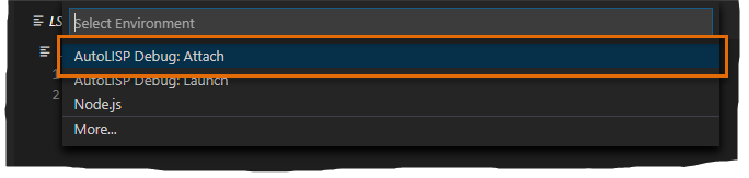

- On the Configurations menu, choose AutoLISP Debug: Attach.
A new file named
launch.json that contains the AutoLISP Debug: Attach configuration should now be open in the current editor window.

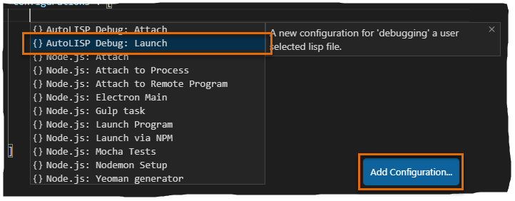

- In the editor window, lower-right corner, click Add Configuration and then choose AutoLISP Debug: Launch from the list that is displayed.
