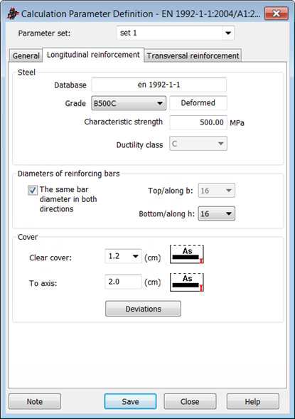

The Longitudinal reinforcement tab allows you to define the parameters of longitudinal reinforcement of an RC member according to the Eurocode 2 (EN 1992-1-1:2004/A1:2014 with different National Annexes).
 Required Reinforcement of Beams/Columns - Options
 Calculation Parameters
			  to open the Calculation Parameters dialog, and then click
The bars are listed in metric diameter units for top/bottom reinforcement. Bar diameters can be different for top and bottom reinforcement of a beam. Similarly, a column can have reinforcement along h and b sides.
If the same diameters are used for the entire element then The same bar diameter in both directions option should be selected.
The cover can be calculated as a cover to axis or clear cover of bottom reinforcement. Cover values are converted automatically.
Click Deviations to specify values of deviations of the cover.
