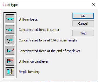

Use this dialog to define the load pattern of the analyzed beam.
Access
		- Click the
			 Load type button in the Member Definitions - Parameters dialog.
		Note: The SP16.13330.2017 code replaces the former SNiP II-23-81 and SP16.13330.2011 versions of the code for steel structures. Therefore, all references to tables or sections of the code apply to the SP16.13330.2017 code except otherwise stated.
Dialog elements
		The information concerning the load type is applied in the calculation of the ψ coefficient value ( Tables Ж.1 and Ж.2), which in turn is used for the calculation of the lateral buckling coefficient according to Annex Ж.
