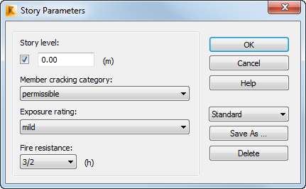

The Story Parameters dialog allows you to define parameters of a story according to the French (BAEL) code.
Select RC Design
 Provided reinforcement layout, and then create a new RC element or open an existing one.
 Story Parameters.
The following options describing a story are available:
The Save As option allows you to reuse a set of story parameters. This set is saved to your current user directory. You can reuse this set for the other element in the Story Parameters dialog or assign it to the selected element (or selected elements of the same type) in the RC Component Inspector.
The Delete option allows you to remove the selected set of story parameters.
