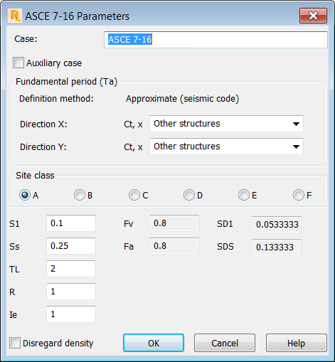

The Seismic Analysis dialog opens.
The Parameters dialog opens.
  The fundamental period Ta is calculated according to the equation 4.6:
Ta = Ct * hn x
where:
Ct - building period coefficient depending on the type of seismic-force-resisting system that is used (given by the code)
x = building period formula exponent (given by the code)
h - structure height (m), defined by difference between Structure range and Reference level
Only Ta on both directions is to be defined.
