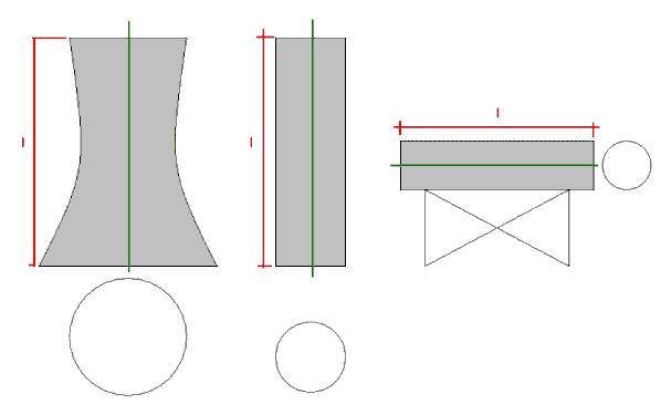

The option generates wind loads on axisymmetric structures (structures whose base is a regular polygon). The option is available for the following codes:
The following image (for the French snow/wind code) shows structure types for which wind loads can be generated.

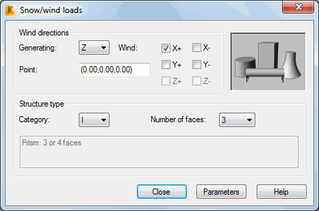

You can start generating snow/wind loads using either method:
At the top of the dialog in the Wind directions field:
The following parameters can be defined at the bottom of the dialog in the Structure type field.
Category - The list of available categories of the calculated structure:
 category I  |
 Prism: 3 or 4 faces  |
 category II  |
 Prism: 5 to 10 faces without curved ribs  |
 category III  |
 Prism: 11 to 20 faces with/without curved ribs  |
 category IV  |
 Cylinder: round base with thin or thick ribs (sharp edges)  |
 category V  |
 Prism: more than 20 faces with/without curved ribs  |
 category VI  |
 Smooth cylinder with round base without ribs (glossy)  |
If category II is selected, the Number of faces option becomes available. You should select the number of axisymmetric structure faces from the list. For the remaining categories, the Number of faces option is unavailable.
