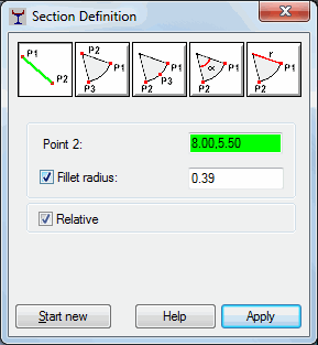

Use this option to define various types of polygons (line, arc) graphically or by typing the coordinates in the appropriate edit fields of the Section Definition dialog.
Access the option by:
If you select Relative and then define a polygon, coordinates of the next vertex are calculated with respect to the position of the preceding vertex. If Relative is cleared, coordinates of polygon vertices are given in the adopted coordinate system.
When defining a thin-walled section, the following options are also available:
 - Defines the line of the section as the section middle line.
 - Defines the line of the section as the section external line.
 - Defines the line of the section as the section internal line.
