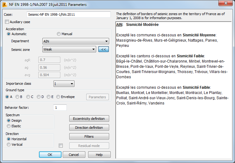

After you select this code, generation of seismic loads is based on the provisional requirements of the NF EN 1998-1/NA:2010p code, not yet released.
To complete the seismic analysis according to the rules given in this code, define the following parameters.
Reference peak ground acceleration on type A ground agR. It defines values of the reference acceleration for the horizontal excitation spectrum agr and vertical excitation spectrum a gv. The design ground acceleration ag is defined in terms of the reference peak ground acceleration on type A ground agR and the importance factor γ derived from the building class:
ag = γ × agR.According to the code, there are 5 seismic zones:

After selecting the Automatic option, you can define values of the reference acceleration automatically by specifying a department and a seismic zone. Click >> to extend the list of zones for a selected department. The definition of borders of seismic zones on the territory of France as of January 1, 2008 is only for information purposes.
After selecting the Manual option, you can specify your own values of the reference acceleration.

If the Envelope option is selected, the Parameters button becomes accessible; click it to open the Spectrum Envelope dialog.
The response spectrum is calculated based on the above parameters using formulas for the elastic response spectrum (points 3.2.2.2 and 3.2.2.3) and for the design spectrum for elastic analysis (point 3.2.2.5).
Click Eccentricity Definition to open the Definition of mass eccentricities dialog where you can specify how to account for the eccentricity of a mass in the seismic analysis
Below in the dialog, the Direction definition, Filters, and Residual Mode buttons are located.
