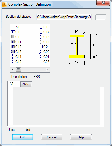

Using this option, you can access a database to define a complex section. You can easily define a complicated section by defining relevant dimensions of a selected section type.
Access the option by:
After the option is selected, the Complex Section Definition dialog displays.
You can import to the Section Definition module a relevant section from the active section database specified at the top of the dialog. The middle part of the dialog has 3 parts:
To import a section to the Section Definition module:
