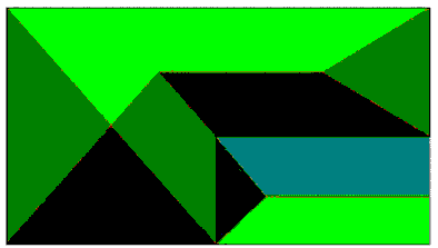

There are also maps of load distribution in the Robot. After selecting the Load distribution regions option in the Display dialog (Loads tab), the load distribution according to the trapezoidal and triangular method is displayed.
On all claddings calculated using the trapezoidal and triangular method, Robot displays maps showing to which supports individual regions belong. Drawing a map consists of applying colors to all the contours of surfaces in such a way that within one slab or cladding a border does not separate contours filled with the same color.
