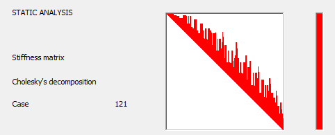

Skyline Method calculations
The calculations dialog for the Skyline method shows the following phases:
- Model reduction (renumbering of nodes and elements)
- Definition of the stiffness matrix for individual structure elements
- Matrix decomposition (Cholesky decomposition)
- Number of blocks.
- Division of the stiffness matrix. A part of the matrix is saved on the disk, slowing calculations.
- Problem solving for successive load cases.
