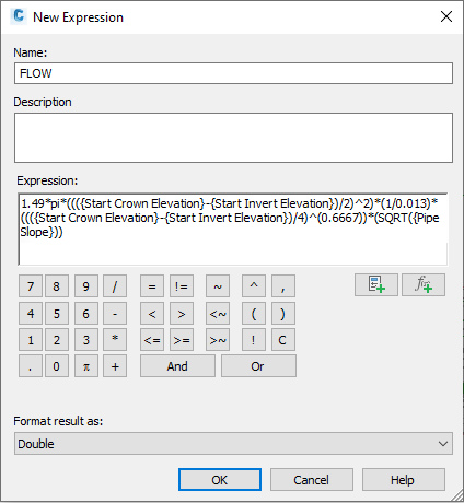

You can create a custom expression for flow in a full circular pipe.
To create the expression
1.49*pi*((({Start Soffit Level}-{Start Invert Level})/2)^2)*(1/0.013)*((({Start Soffit Level}-{Start Invert Level})/4)^(0.6667))*(SQRT({Pipe Gradient}))
Figure 11: Flow capacity expression
The term ((Start Soffit Level – Start Invert Level)/2) has been substituted for Pipe Radius. The use of Pipe Radius, which is a named component of the pipe, does not work correctly in this case. Similarly, do not use the {Inner Pipe Diameter} component.
This expression assumes a Manning’s “n” value of 0.013, which is the standard for concrete pipe. In fact, pipes have a named component for Manning’s “n” value, which you can set. However, adding that component to your expression yields an undesired result, so you should not use it for this procedure.

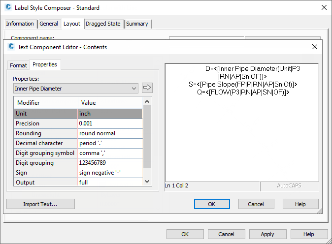

The next step is to create a pipe label style for plan and profile that displays this value for flow. Figure 12 shows an example of this label style with all the pertinent hydraulic settings:
Figure 12: Use the text component editor to display flow capacity (Q)
Display the flow capacity for design purposes. When you want to produce your construction plans, assign a style more suitable for production drawings. As pipes are created and labeled, the label style DESIGN FLOW will display the flow capacity (Q) of the pipe.
