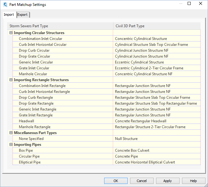

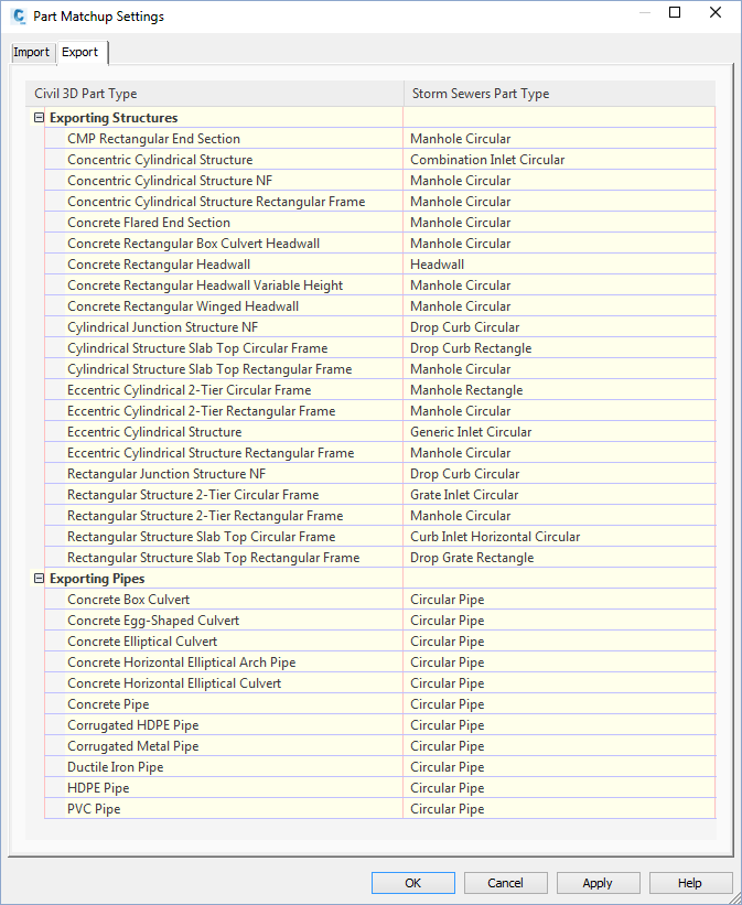

A best practice is to determine what Junction Types are being used in a given Storm Sewers Project (stm file) and set up the Part Matching Defaults to ensure that:
  1. Each Storm Drain part used is matched with a unique Autodesk Civil 3D Part Family in the Import Tab.
  2. Each of those Autodesk Civil 3D Part Families that match the Storm Drain parts that are in the STM file are matched to the appropriate Storm Drain part in the Export tab.
The Autodesk Civil 3D drawing templates contain proposed matching settings as follows:
Import settings:
Export settings:
