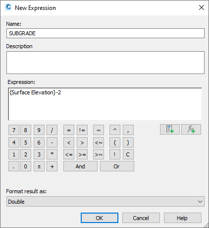

Spot Level Expression
With label styles, you can create and name mathematical expressions based on the components of the objects they are labeling. For example, you can create an expression for spot levels on a surface, which subtracts a given value from the actual surface level. The expression could be called SUBGRADE and the composition might look something like this: {Surface Level}-2, where Surface Level is a component, or named property, of the surface.
After it is created, that expression can be used as a component for label styles and table styles. Simply create a Spot Level surface label style employing the expression called SUBGRADE. Use the New Expression dialog box, as shown in figure 10.
Figure 10: Surface label style expression
