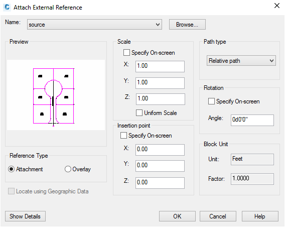

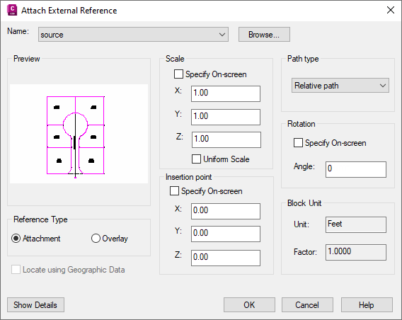

  1. Maximize current.dwg, and click Insert Tab Reference panel Attach . In the Select Reference File dialog box, navigate to source.dwg, select it and click Open.
  2. In the External Reference dialog box, set Insertion Point to 0,0,0, Scale to 1,1,1, and Rotation Angle to 0.
    It is recommended that you set the Path Type to Relative Path.
    Figure 15: Required settings for Xref labeling
  3. Click OK.
