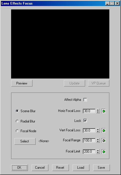

Interface
The Lens Effects Focus dialog contains a preview window, and an area below to control the parameters of Focus.
[preview group]
- [preview window]
- Lets you quickly preview the Focus effect.
- Preview
- Displays a generic scene to which you can quickly set up a Focus effect. Appears light green when selected.
- VP Queue
- Lets you preview the scene in the Video Post queue. Preview must be selected for the VP Queue function to work.
[Focus control group]
The settings on the left side of this group let you select a method for blurring your scene. The settings on the right side let you determine how much blurring is applied to the scene.
Scene Blur Applies the blurring effect to the entire scene, not just a portion of it.
Radial Blur Applies the blurring effect to the entire scene in a radial fashion, starting at the center of the frame. This is useful for emphasizing fish-eye lens effects and effects where the edges of the frame are blurred. This type of Focus depends on the Focal Range and Limit settings.
Focal Node Lets you select a specific object in the scene as the focal point for blurring. The selected objects remains in focus, while objects outside of the set
Focal Limit are blurred.
Select Displays the Select Focal Object dialog so you can select a single
3ds Max object to use as the focal object. The object you select can be animated over time, which results in animated follow focus effects. You can also choose your camera target as the focal object so its depth in the scene determines the focus.
- Affect Alpha
- When this option is selected, the blur effect is also applied to the Alpha channel of the image when you render to a 32-bit format. Select this option to composite the blurred image over another.
- Horiz. Focal Loss
- Specifies the amount of blur applied to the image in the horizontal (X-axis) direction. Values range from 0 to 100% focal loss. This parameter can be
animated.
- Lock
- Locks the horizontal and vertical loss settings together. When selected, the vertical focal loss is automatically updated to match your changes to the horizontal loss.
- Vert. Focal Loss
- Specifies the amount of blur applied to the image in the vertical (Y-axis) direction. Values range from 0 to 100% focal loss. This parameter can be animated.
- Focal Range
- Specifies how far away from the center of the image (Radial Blur) or from the camera (Focal Object) the blur effect begins. Increasing values move the radius of the effect farther away from the camera or the center of the image. This parameter can be animated.
- Focal Limit
- Specifies the distance from the center of the image (Radial Blur) or the distance from the camera (Focal Object) at which the blur effect is at full strength. Setting a high Focal Limit with a low Focal Range, produces a gradual increase in the amount of blur in the scene, while setting Focal Limit and Range close together produces a rapid blur effect over a short distance. This parameter can be animated.
Note: Do not set Focal Range and Focal Limit to the same value. This produces an abrupt change from a blur to a sharp focus, producing an undesirable visual effect.
Warning: When you animate Lens Effects parameters, this creates pointers into the actual scene, so Lens Effects animation is lost if you save the Video Post queue in a
VPX file. To preserve the animation, save the Video Post data, including Lens Effects animation, in the MAX file.
- Reset
- Resets Lens Effects Flare to its default settings.
- Load
- Displays a Windows-standard file open dialog from which you can select the settings file you want to load.
- Save
- Displays a Windows-standard Save As dialog in which you specify a directory and filename. Lens Effects Focus settings are saved as LZO files.
