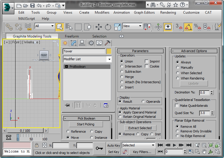

To resize the command panel in its docked location, drag its edge to the left or right:
Note: You can find more video content in this topic online. See http://www.autodesk.com/3dsmax-docs
Multiple command panel columns are useful when working with objects such as ProBoolean or PFlow, which have many controls.
