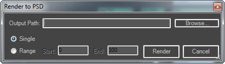

- Create PSD
- Opens the Render To PSD dialog for generating and saving a Photoshop-format bitmap image based on the Compositor Output node. Click the Browse button to set the output path and file name, then click Render.
State Sets renders each state or element to a separate layer of the PSD file.
State Sets saves alpha data in a Layer Mask for each layer, making it easy to control compositing in Photoshop.
The image is rendered using the Output Size setting on the Render Setup dialog.
