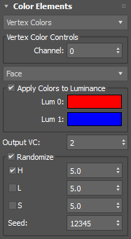

Color Elements Parameters rollout
Example with Vertex Colors input selected. Parameters vary with other inputs.

Vertex Color Controls group
Channel
Sets the vertex color channel. Displays only when Vertex Colors is selected as the input.

Color By menu
Selects coloring by Face or Element.
Apply Colors to Luminance toggle
When enabled, applies colors as a gradient to the luminance value. Click the color swatches to assign the colors.
Output group
Output VC
Selects a map channel for outputting the vertex color.
Randomize
Randomizes based on hue, luminance or saturation. Use the Seed field to change the pattern.
