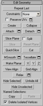

For detailed descriptions of these controls, see Edit Geometry Rollout (Polymesh and Edit Poly).
