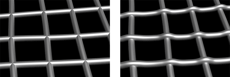

The Spline Overlap modifier detects self-overlapping splines and adjusts the displacement of the intersecting segments.
A section of chainlink fencing created using a freehand spline with the Spline Overlap modifier applied (right).
