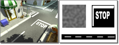

Left: Scene uses different map channels to place different copies of the same maps in different locations.
Right: The three maps used to create the streets and the traffic markers painted on them
